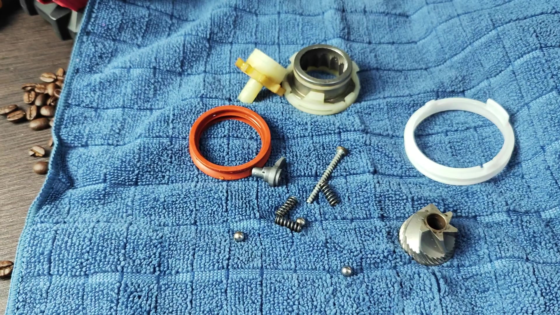

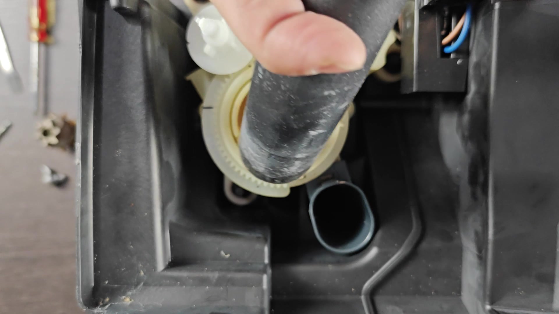

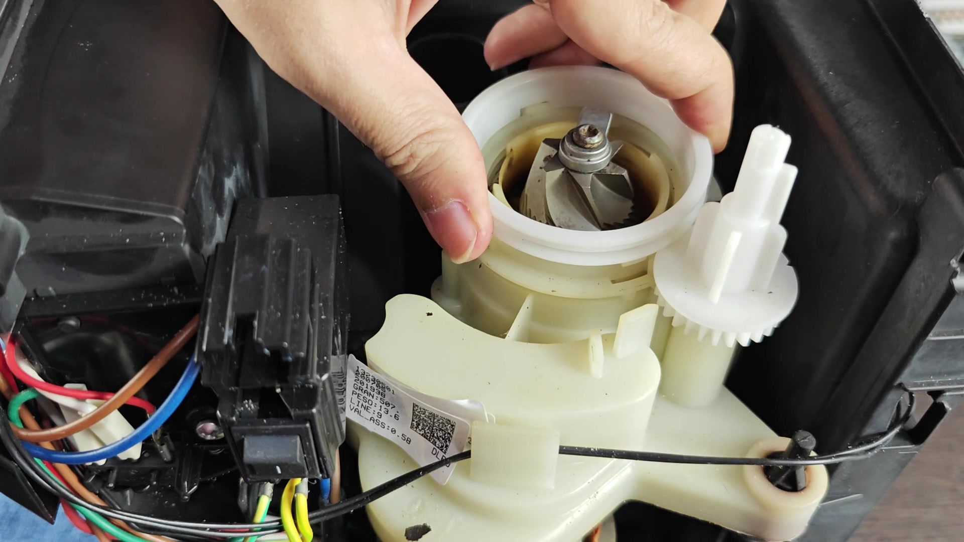

Take the machine apart and find an orange rubber ring on the grinder. Remove the ring and the white bracket that hold the grinder. Remove the center screw by turning it clockwise (counter intuitive). Remove the blade and clean it. Put the blade back in place and tighten the center screw going at the opposite direction (anticlockwise). Replace the rubber ring and white bracket. Ensure there is no coffee ground or other foreign object trapped in the grinder. If it still will not spin then the grinder motor is likely broken and need to be replaced.

Done maybe 5 of these now. 4 out of 5 times its just packed grounds and oil gunk around the burr. The motor itself fail less often than people think. The reverse thread for the center screw is something that trips people up when they is first doing this fix.
