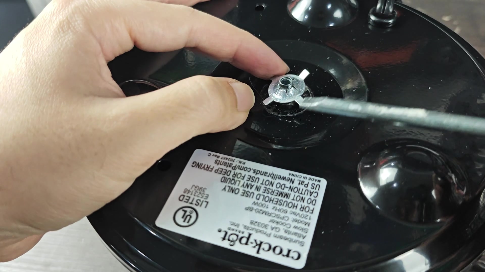

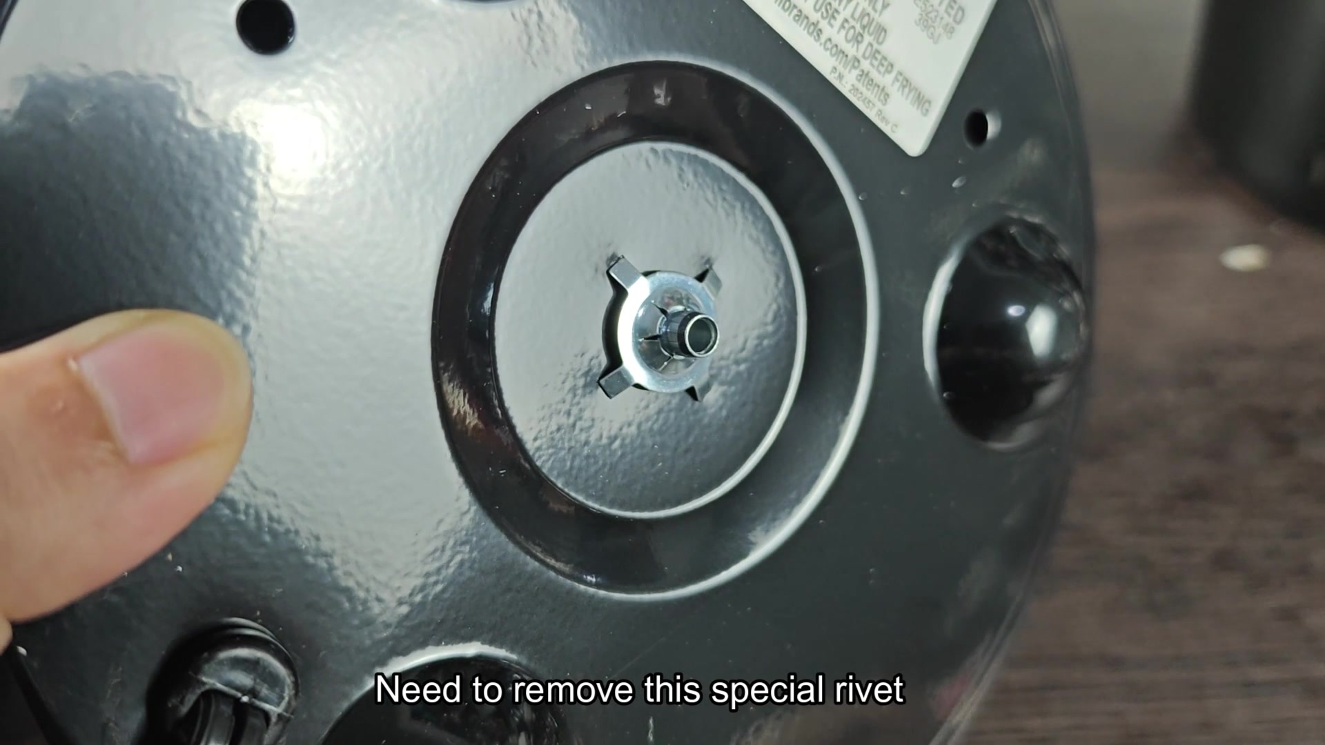

Just browsing an internet looking for information on how people gets into the bottom of these little mini Crockpots. From what I am finding online, the mini crockpots use what appear to be some kind of special rivet on the base to secure the cover.

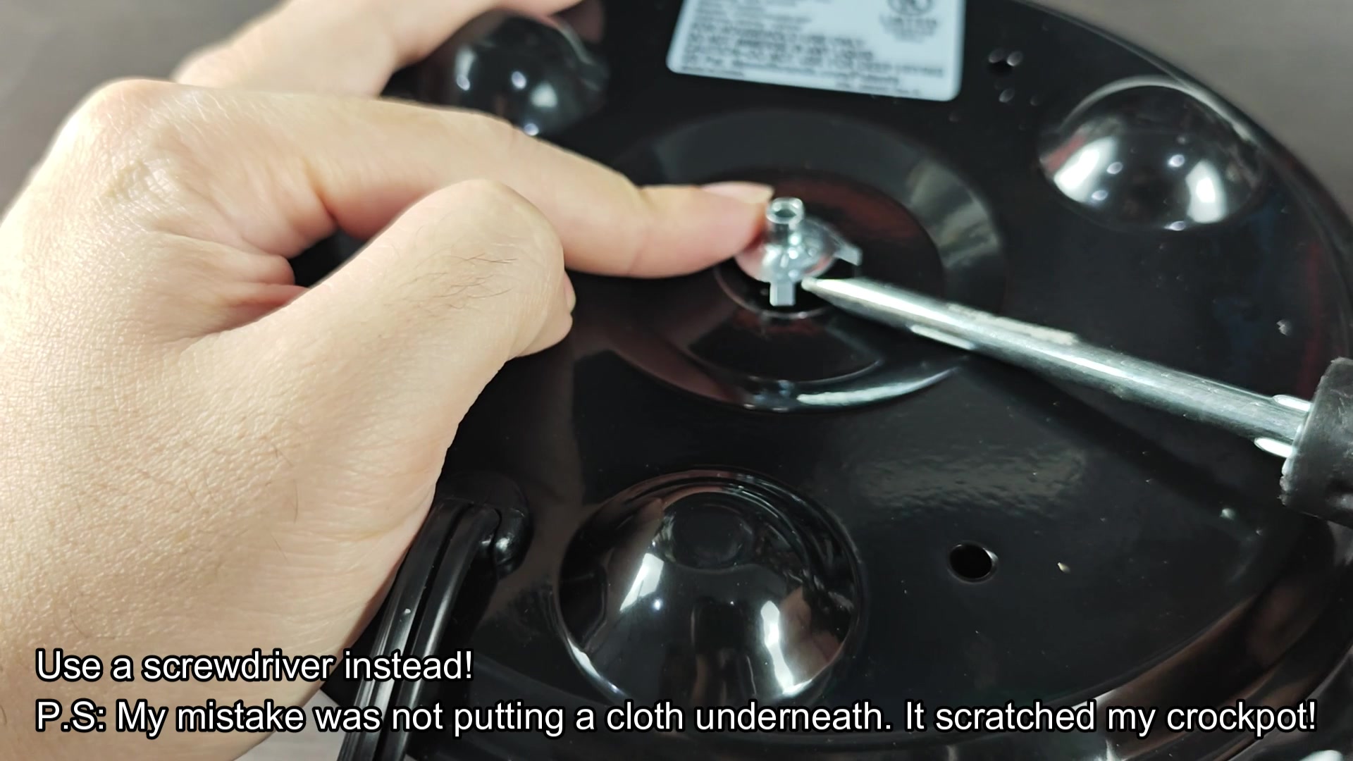

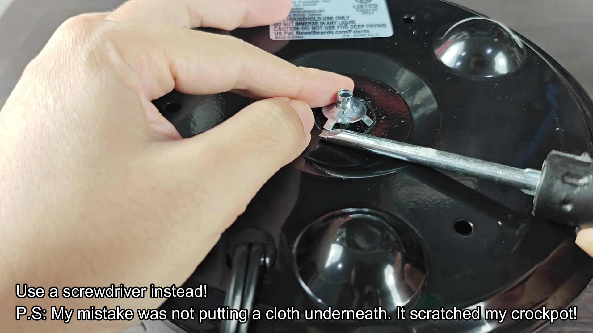

There is no information about pliers on the internet to assist with getting into these model. The rivets is not designed to be prying with tools like pliers. It is recommended that you use a flathead screwdriver to pry these rivets off the base of the crockpots.
However, caution are advised when doing so since it is recommended that you place a cloth underneath the flathead screwdriver to avoid damage the crockpot. The plastic on the crockpots isnt the most durable material.

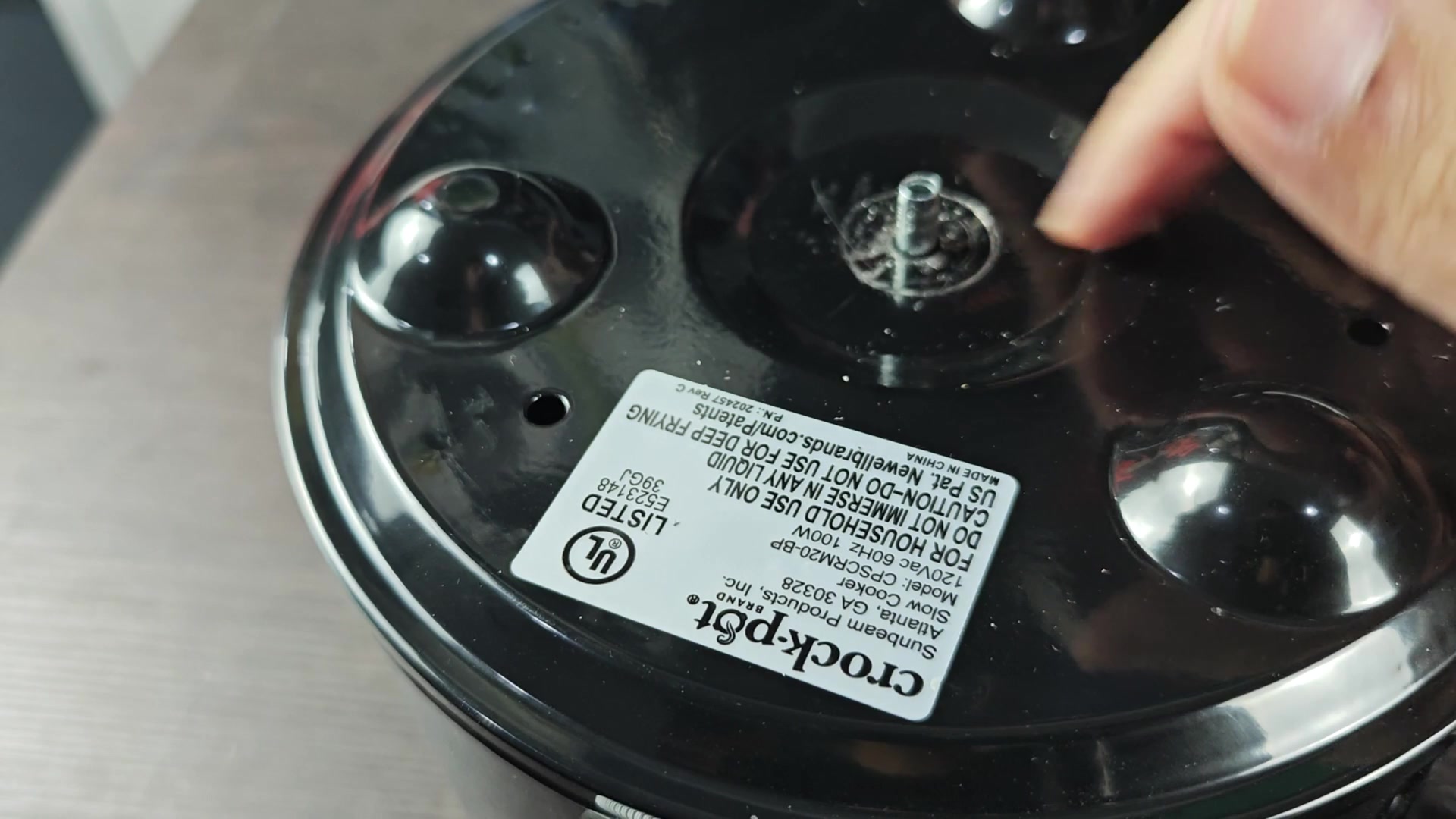

yeah those are pop rivets basically. Drilling is cleaner than prying imo but you gotta size your bit right or you elongate the hole and theres nothing to grab when you reassemble
Done two of these. The rag trick works but honestly a small flat pry bar with some painters tape on the housing is way less sketchy than a screwdriver. Screwdriver tip slip, pry bars are designed for this.
i pried one open last summer with a flathead and it took maybe 4 minutes total. The rivets are soft pot metal or aluminum so they deform real easy. The rag tip is legit tho, mine slipped once and left a nice scar in the plastic
Not all mini crocks use the same fastener. The older ones with the round dial actually has phillips under the rubber feet. Pry the feet off first before you go drilling anything you might already have screws hiding under there.
those arent rivets theyre called tamper proof spin rivets or sometimes one way fasteners. They spin freely so you cant back them out with a driver. Manufacturers use them so you cant easily get inside the product. Drilling them is the correct method to remove them from the product. Prying can damage the housing of the product and those who recommend this method has never done it properly. Use a 7/64 bit and apply light pressure to the spin rivet and the head will pop off and the shaft will fall out the other side

yes, use a small punch or even a nail and tap with a hammer. Its hollow on the inside of the housing so theres room for the shaft to drop thru
