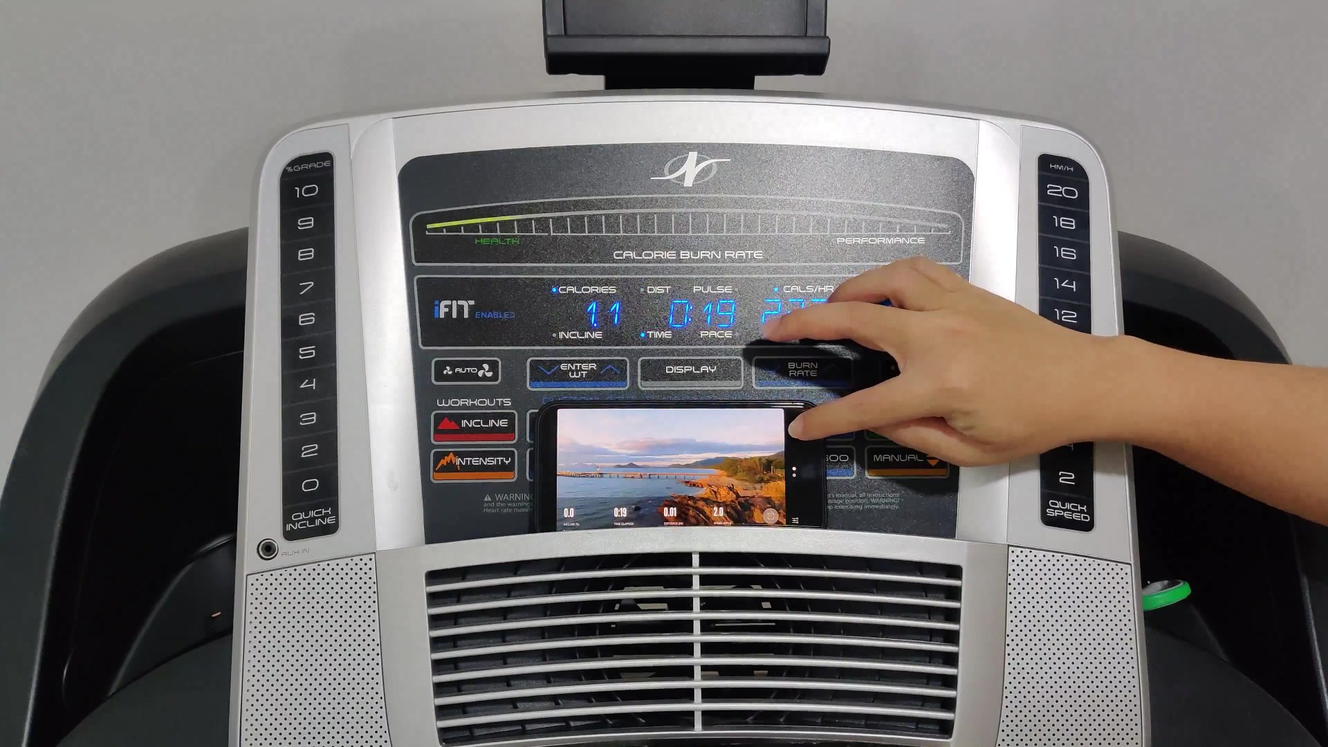

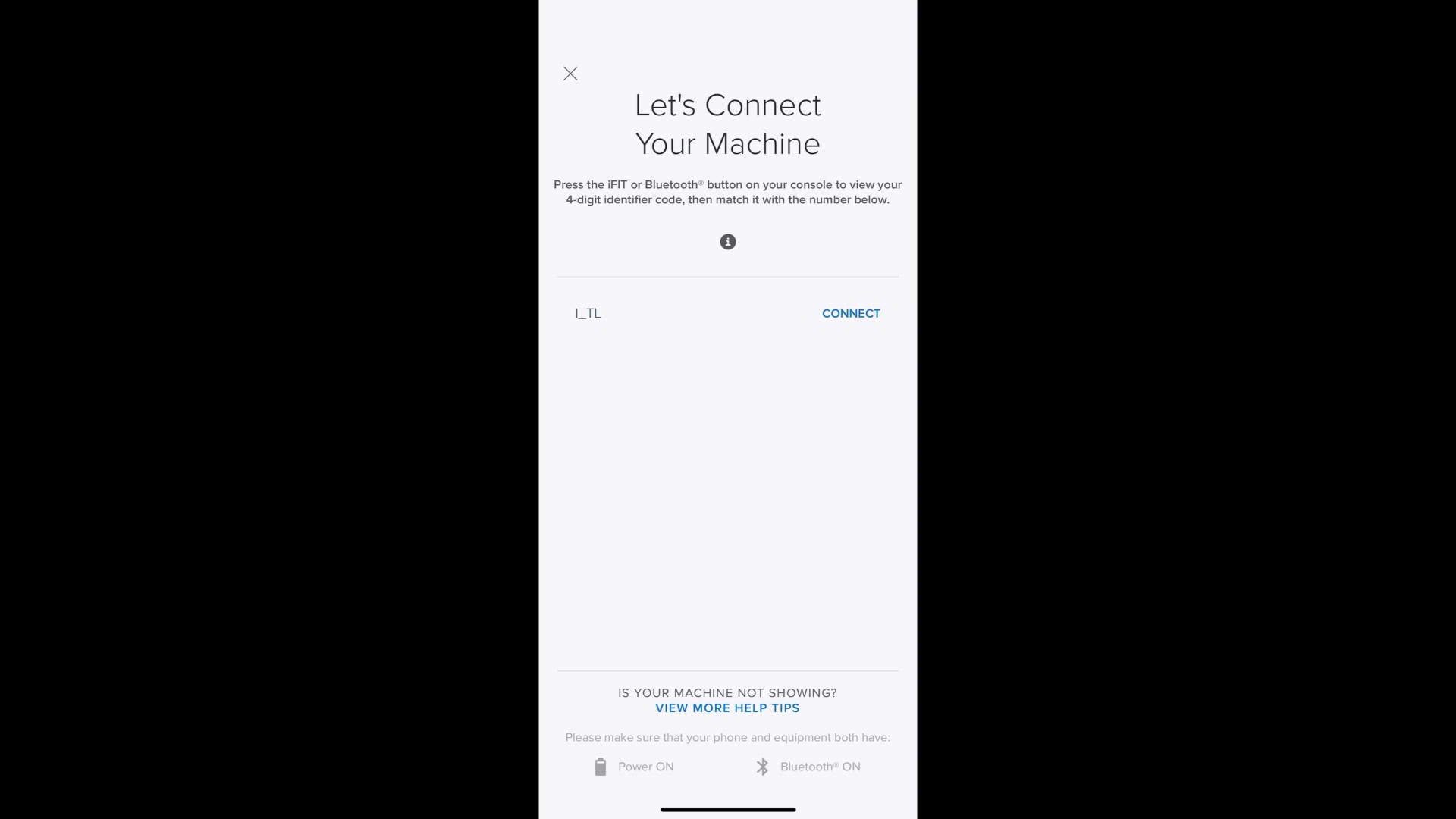

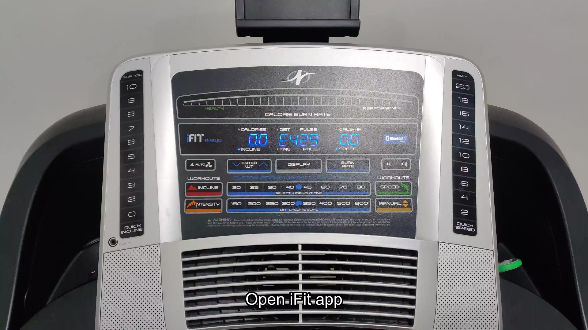

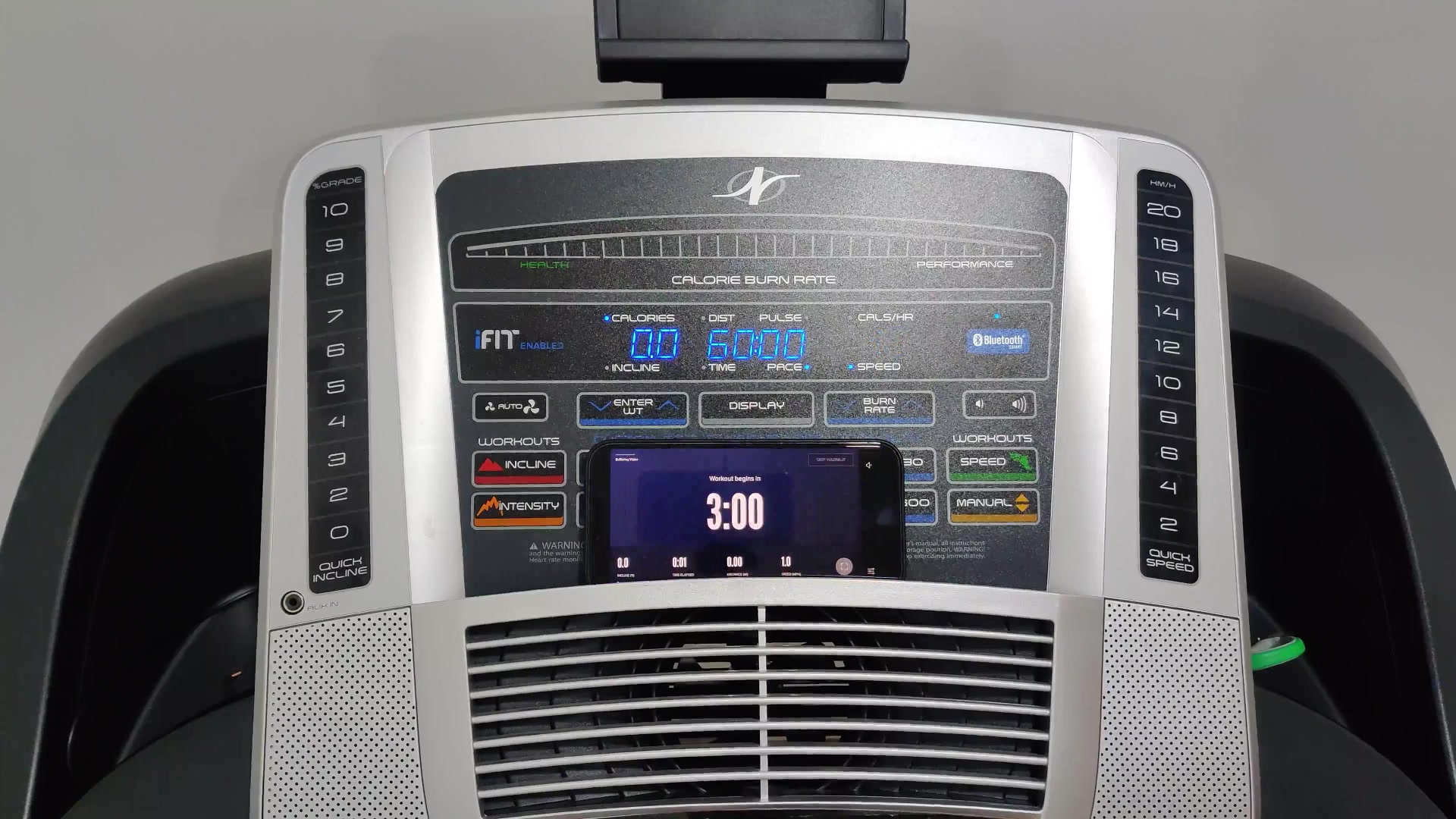

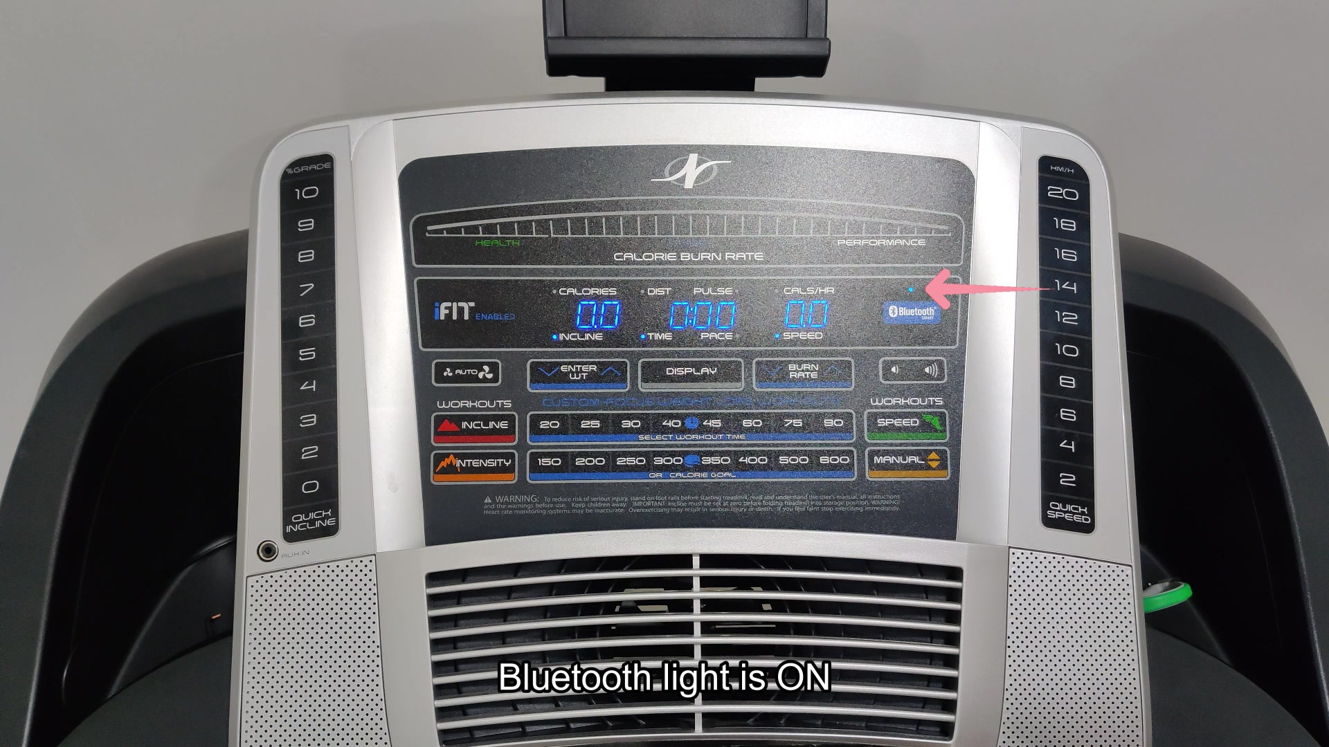

Been reading up on this because others has brought it up in different forums. The answer, as with most things related to treadmills and fitness technology in general, seem to depend entirely on the model. If your treadmill have what is labeled as a "Bluetooth Smart" button on the console, it will not pair via bluetooth in the typical way that you may be used to see on most devices in your home or even with bluetooth devices like headphones. Instead, you would have to download the iFit application on your mobile device, hit the Bluetooth Smart button on the treadmill, and then pair the treadmill to your phone through the iFit application.
