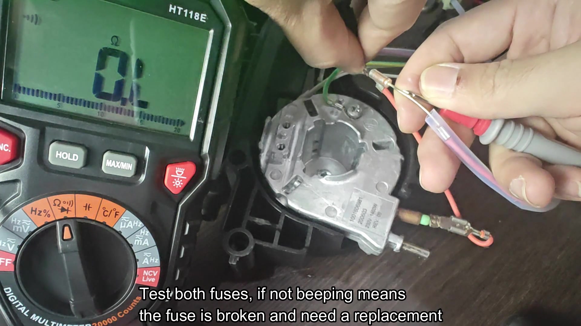

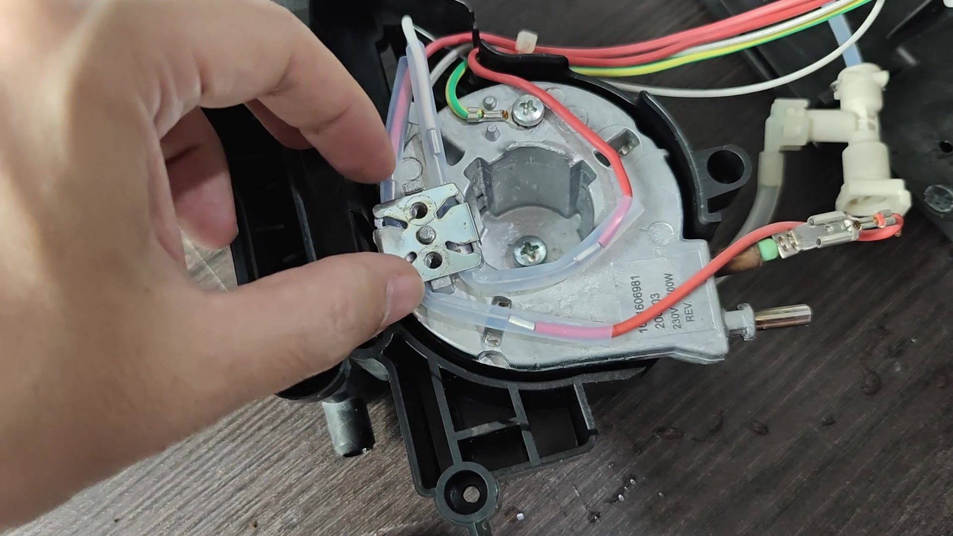

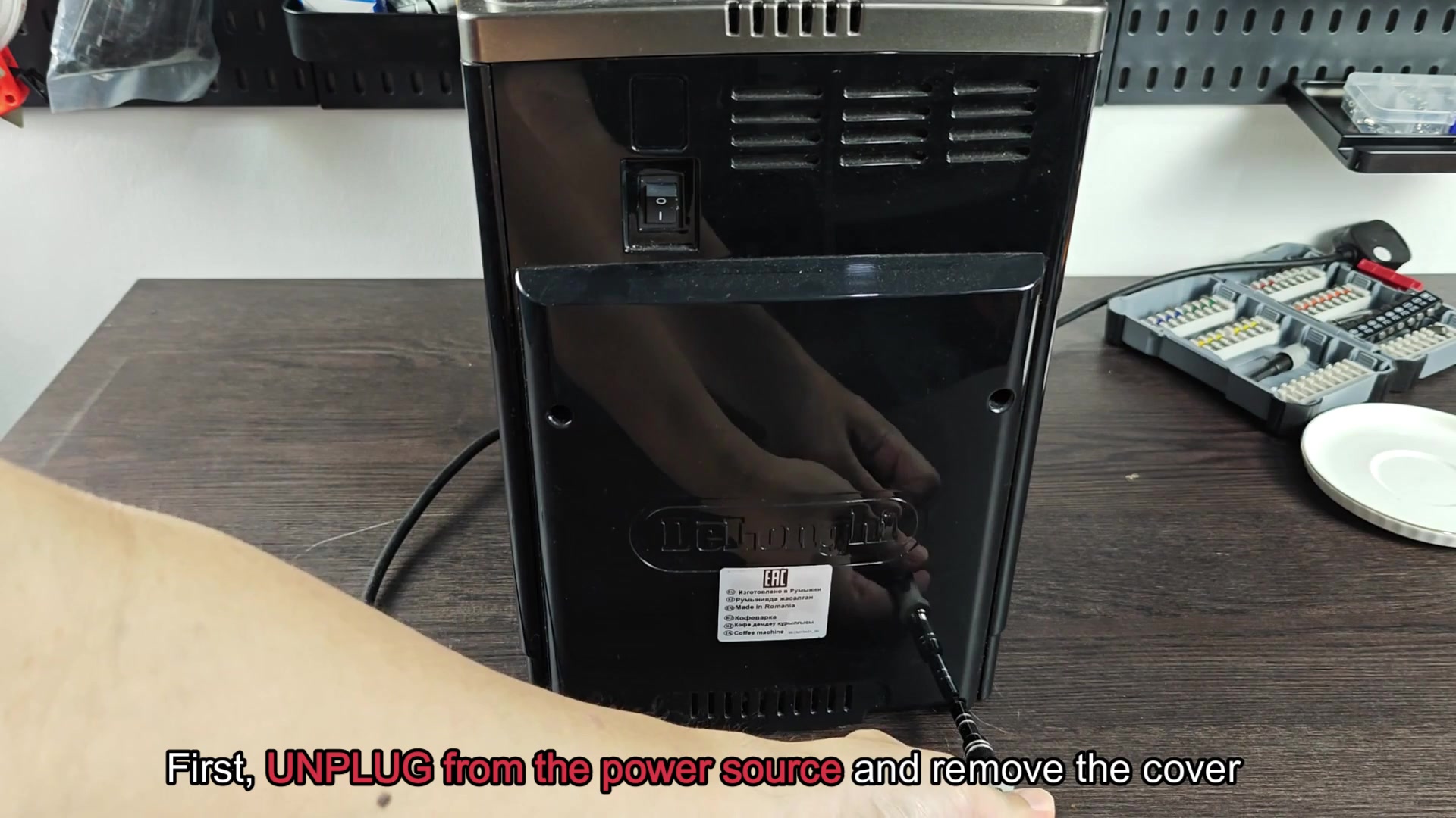

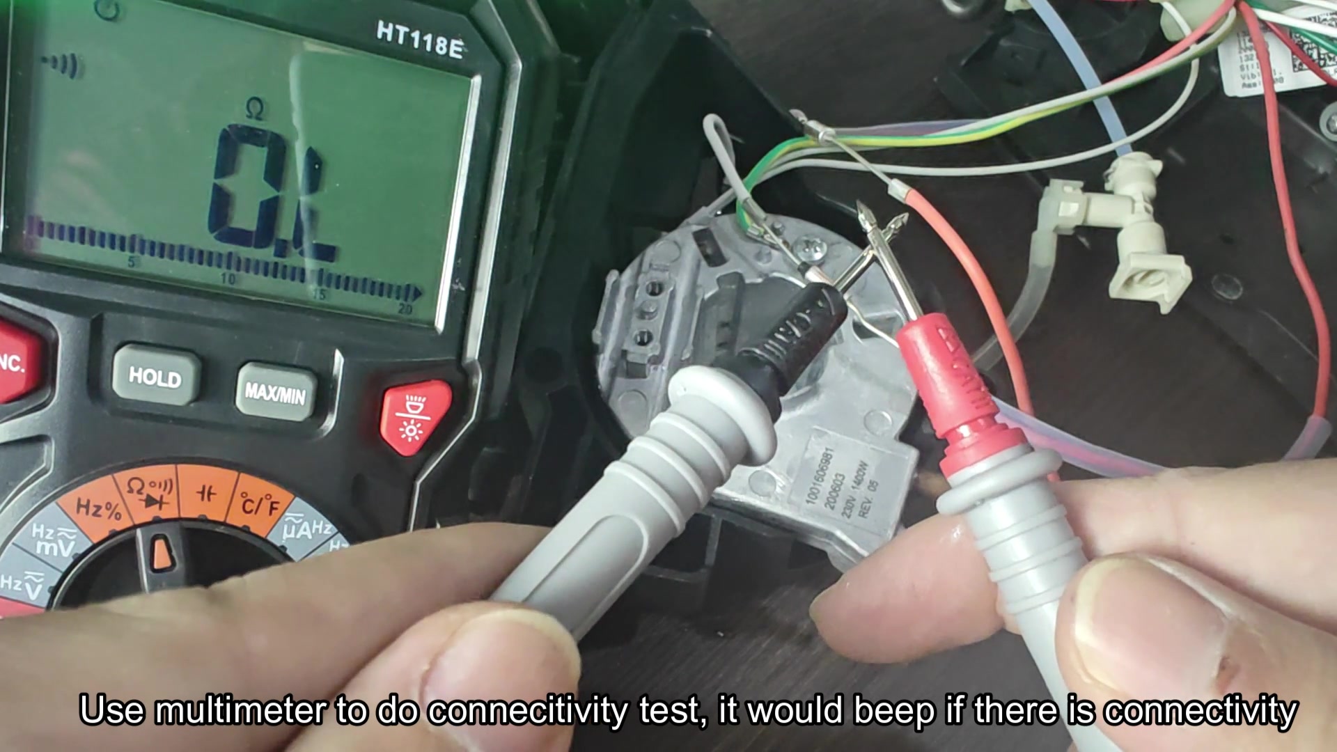

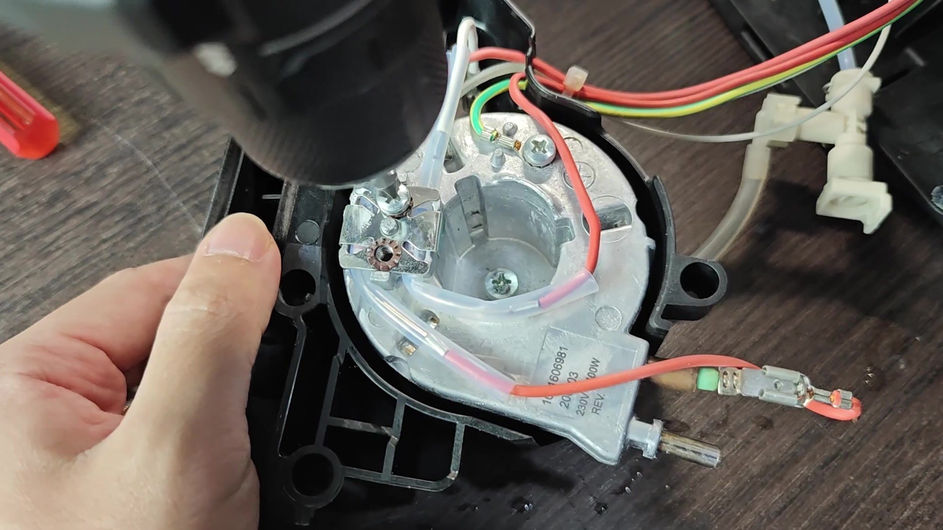

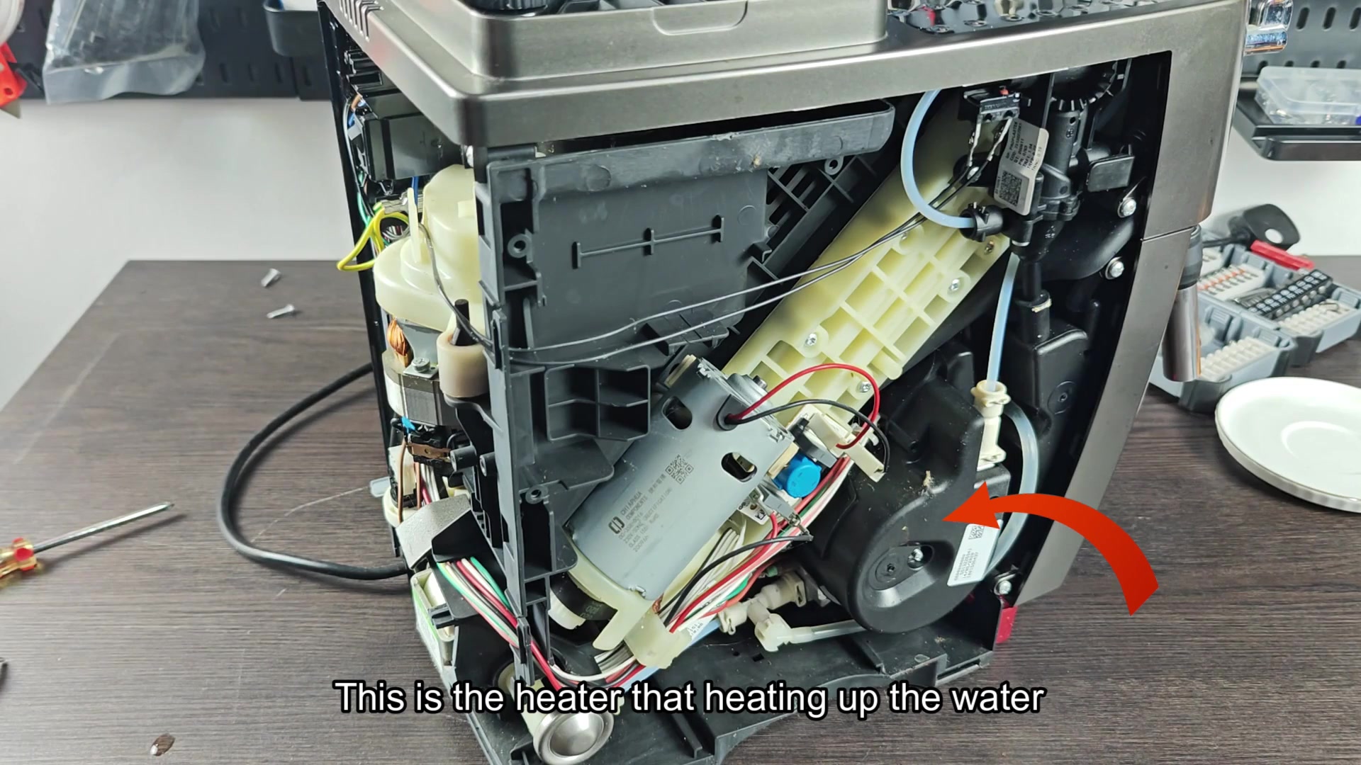

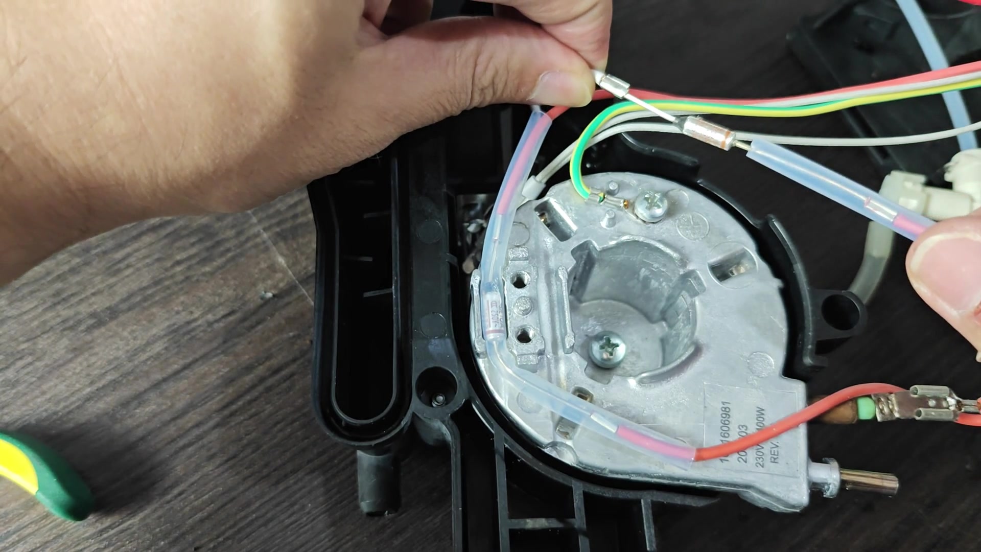

To check the fuses you simply unplug the machine and remove the covers. Under the machine is the heater that you can unscrew to reveal the two fuses. Use a multimeter to test each fuse for continuity. If one of them reads no continuity (as an open circuit) then it's the faulty one and can be replaced. How often do you find that just one of the fuses is bad instead of both? Any reason for this occurrences?

9 times out of 10 its the fuse. I've done 15 of these and only one where it was the element that failed. The fuse is a sacrificial part of the machine.
scale. It's always scale. These are run on hard water, not descaled and then people get suprised when the fuse blow on them due to the scale on the heater element
The original manufacturer fuse is a waste of money. A generic fuse of the same specs will work just as well. They are a one shot fuses. I get them on ebay for 2 bucks each.

Did one of these on a Magnifica last end of week. Pump fine but no heat. Found one fuse open. Replaced with a generic 192C fuse and it's working great. 3 dollars and 20 minutes of my time. The hardest part was getting the silicone hose off the machine but then I figured it out. I wouldn't let a coffee machine sit idle without regular maintenance.
