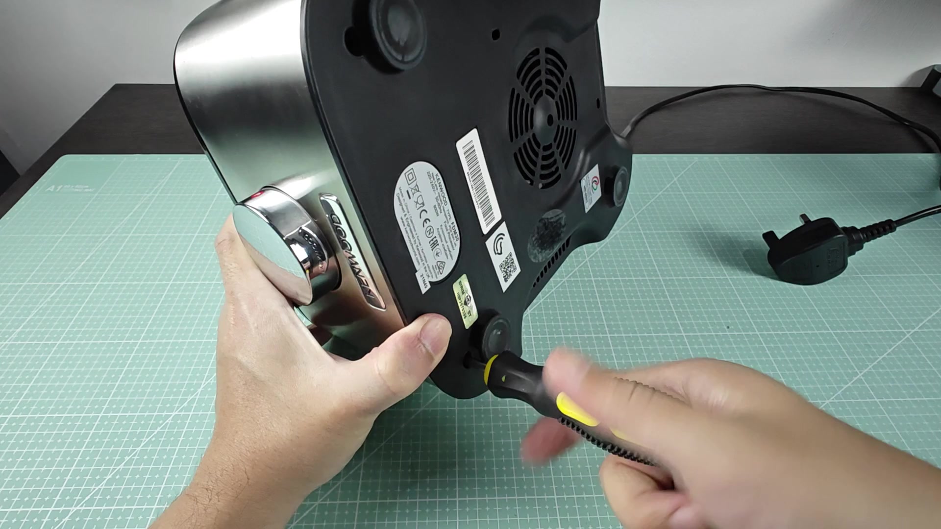

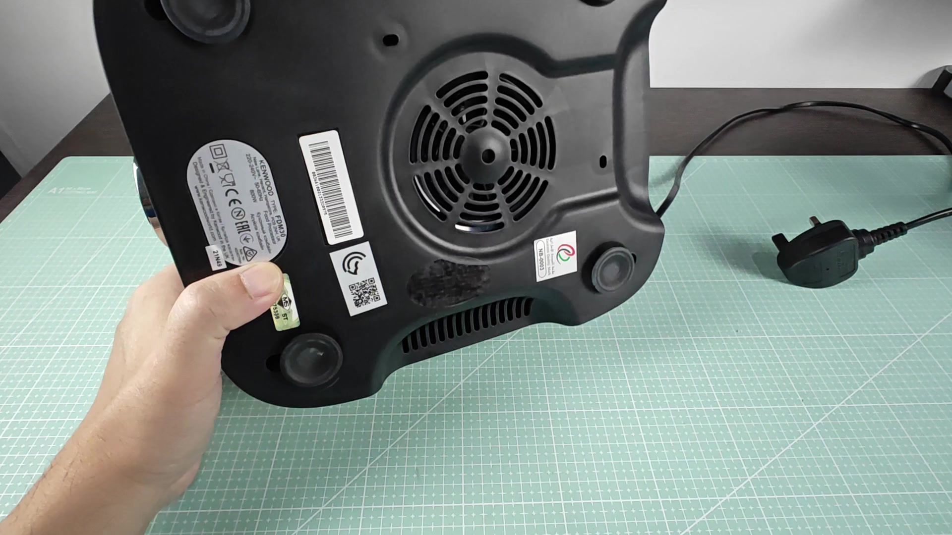

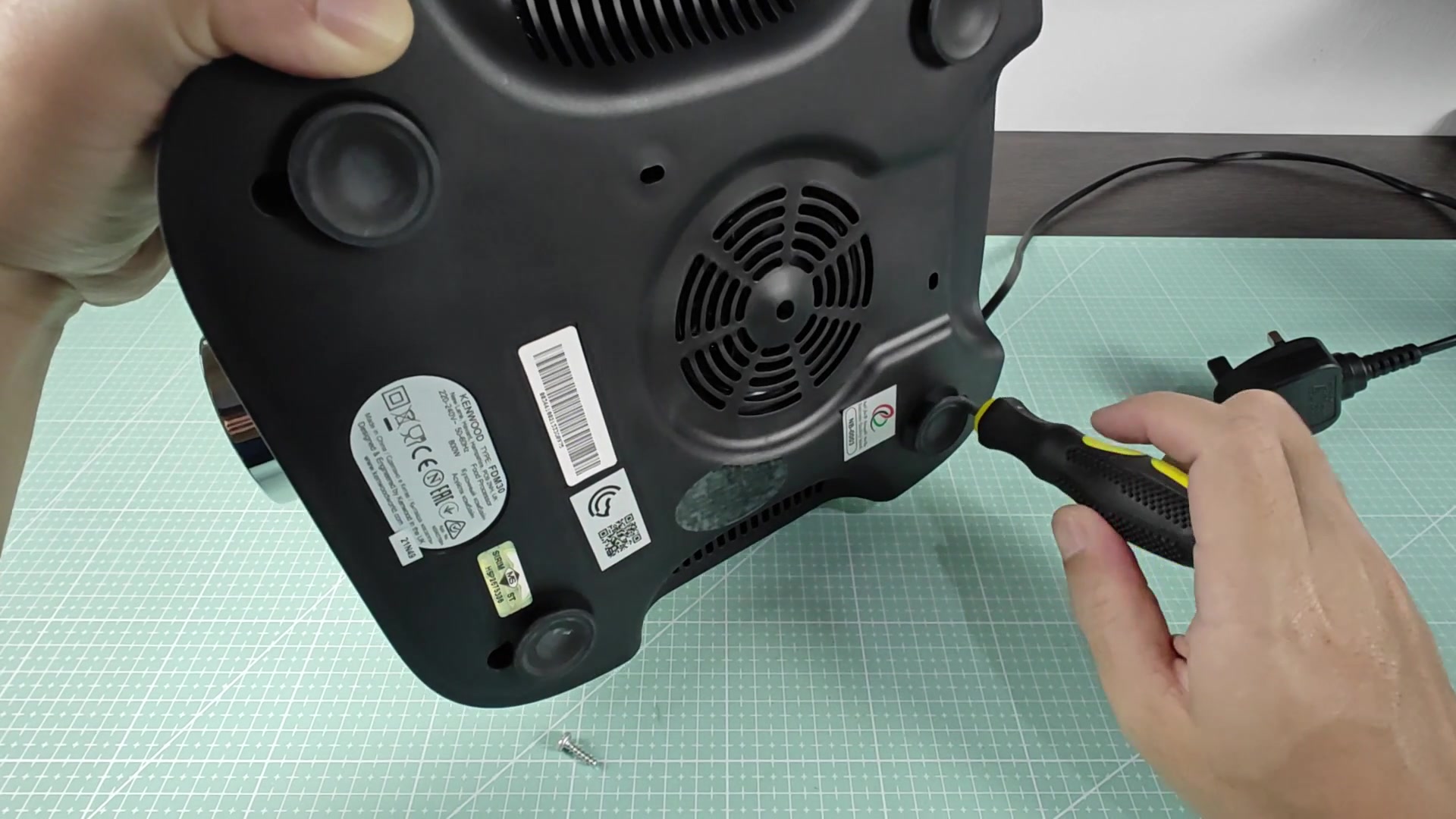

yeah the rubber feet thing is real on the older FP series. Peel em back and theres usually 1 or 2 screw hiding under. Not all of em though, depends on model year like you said.

opened a multipro last year. Screws under the feet, cover popped right off after that. No hidden clip on mine.

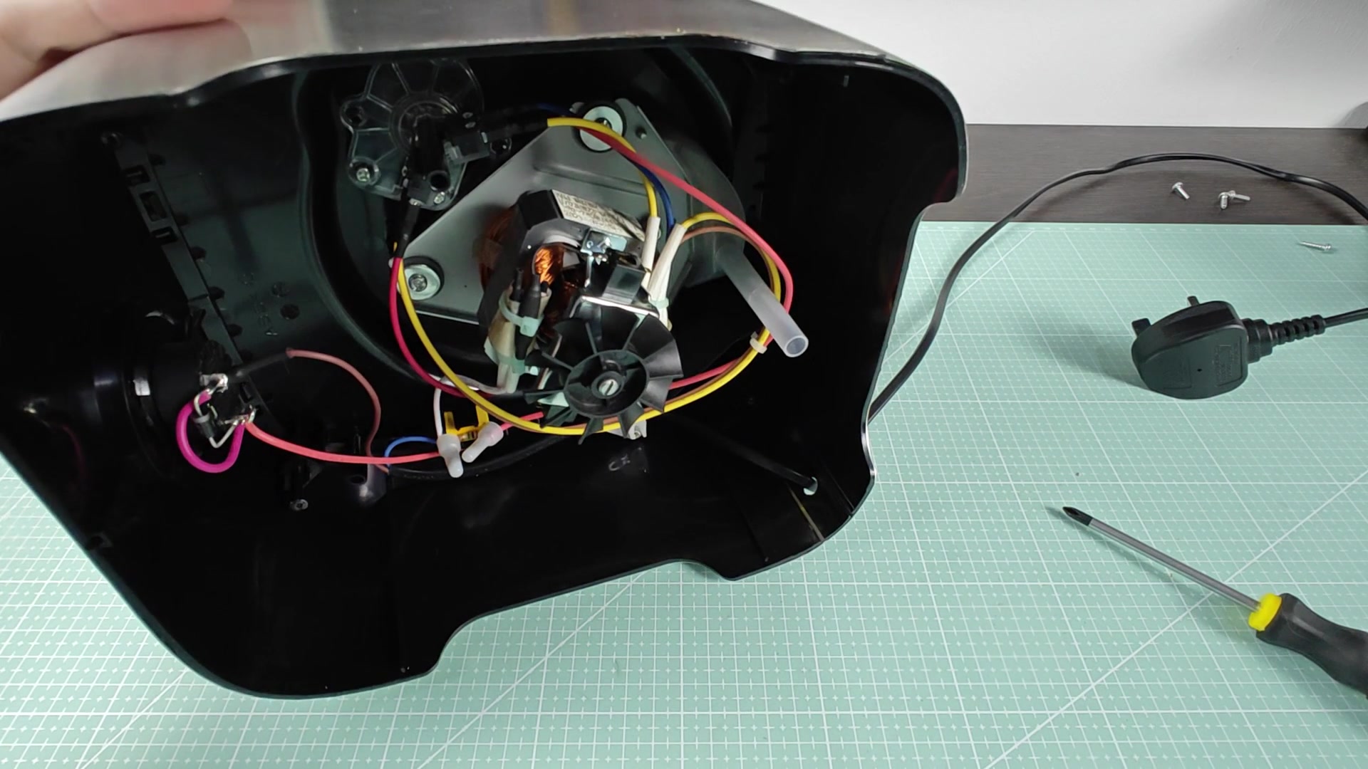

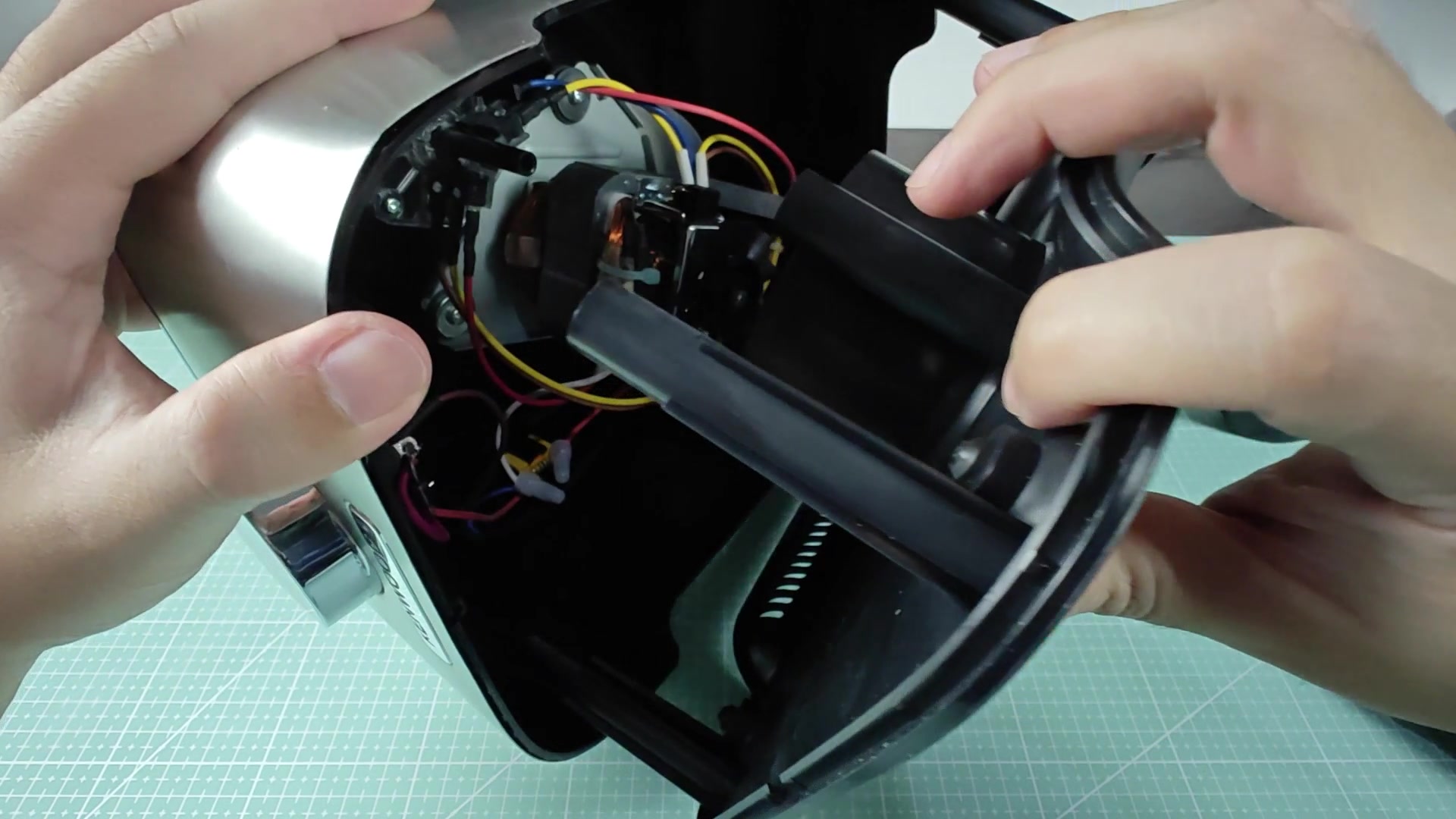

Got into an FPM250 a couple years back to fix a dodgy interlock microswitch. Bottom access got me to the motor and the main switch assembly but the interlock switch is mounted to the upper part of the machine so had to pop that off as well. There was a screw under the speed knob that i missed when i dismantled the lower part. Once i got that the upper part snapped off. The motor was brushed and the speed control and thermal fuse under the field winding.

if its stuck after the screws are out 9 times out of 10 its a screw you missed not a clip. Trust me ive been there feeling like a muppet trying to pry a cover thats still bolted down
