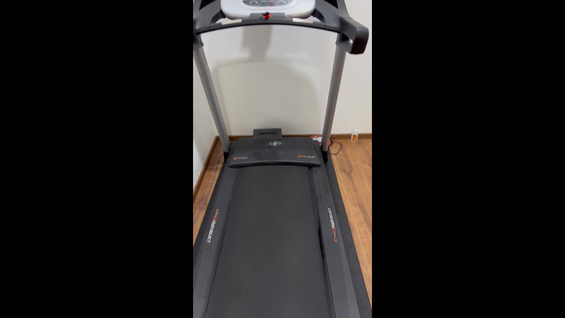

Had the problem of my treadmill’s belt sliding off to one side while in use. Friction were noticeable and somewhat bothersome. Initially thought it was due to a warped deck which would be pricey to fix. Ended up it was just tension.

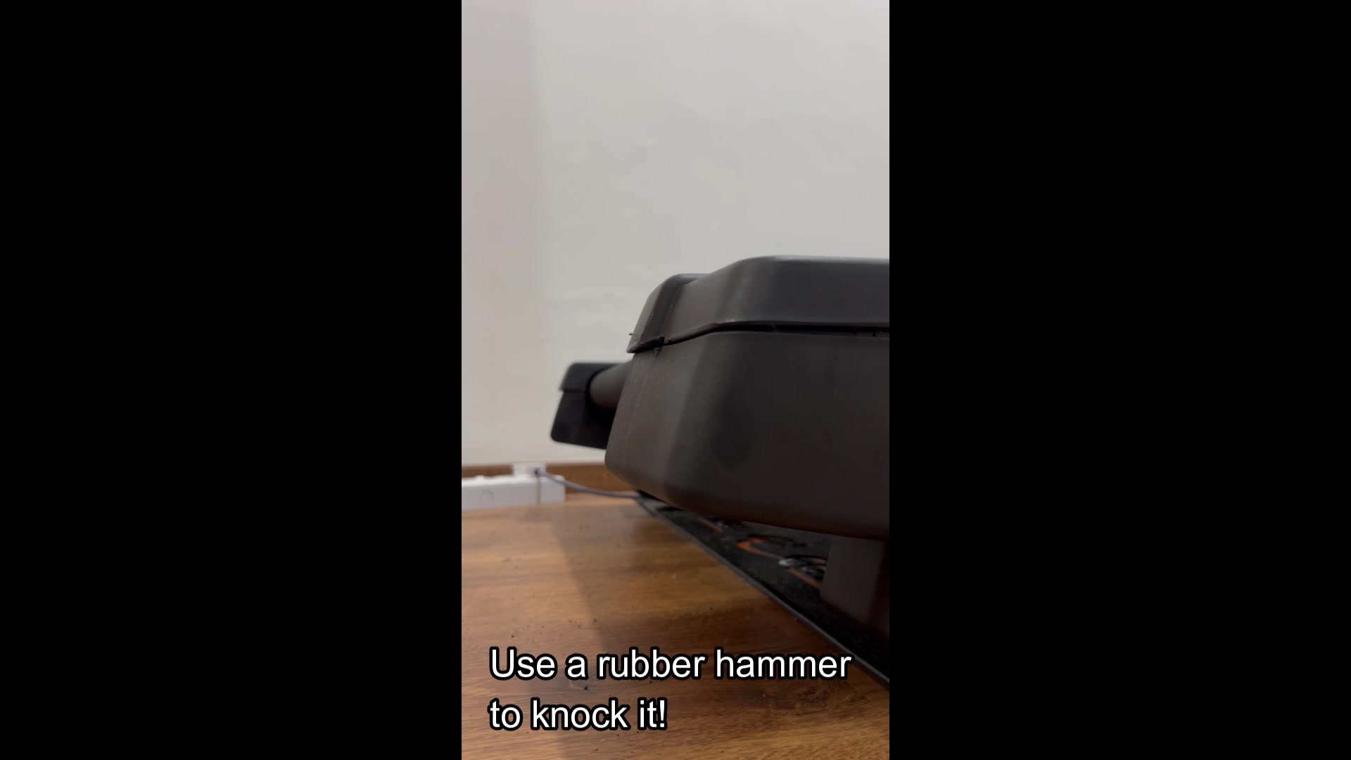

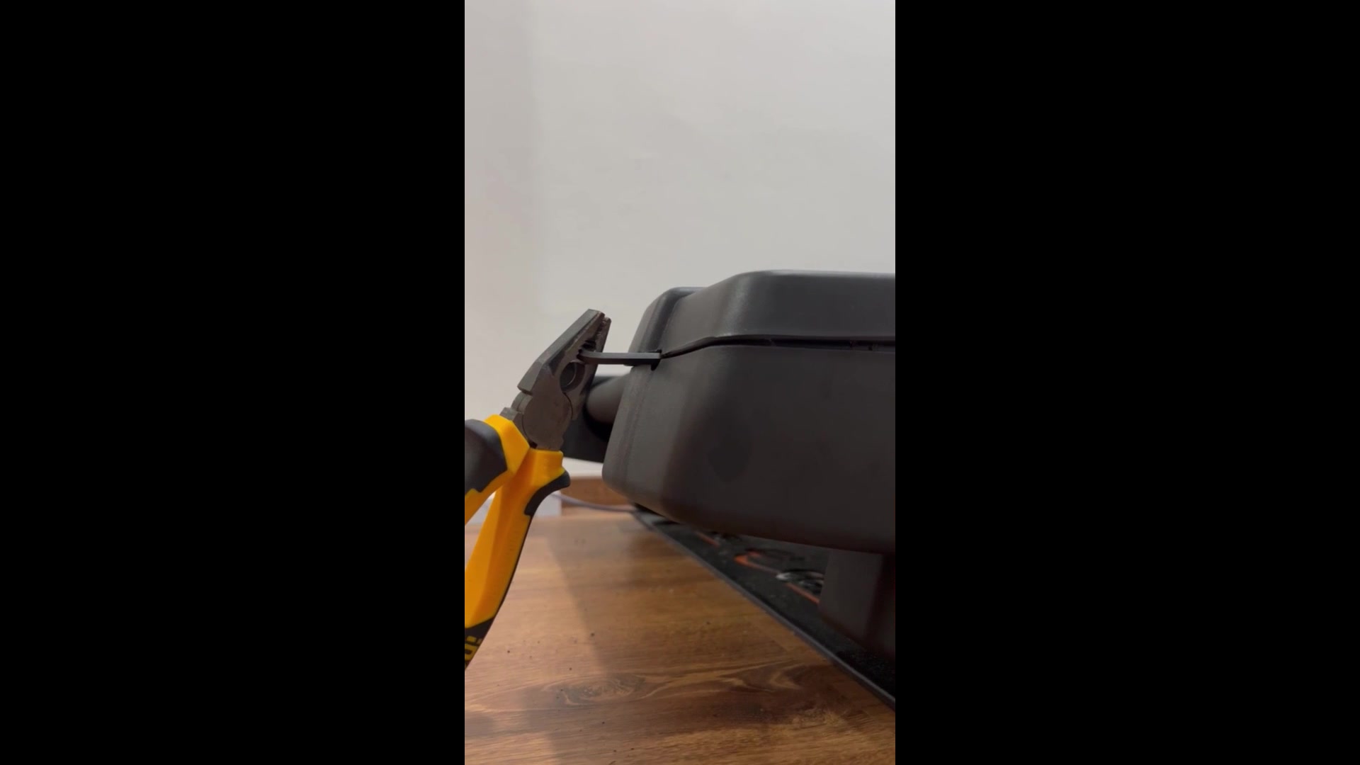

Had to purchase an hex key and adjusted the tension on each side. Had to ensure that the adjustments was even on each side or else the belt would end up pulling to one side or the other. Initially, the belt was too tight on one of the bolts so I had to tap it with a hammer to loosen it. Pliers could of also be used. Once evened out, adjusted the tension on each side to where the belt remained centered on the treadmill.
Initially thought it would be more involved than just adjusting the tension. Was surprised at how easy it was once knowing which way to turn each bolt. Small adjustments is all that is needed as going too far in one direction or the other will cause the belt to drift in the other direction.

Did mine last month, same exact symptom. Hammer trick worked for me too. Belts tend to seize those bolts up with the gunk that builds up from the treadmill belt.
