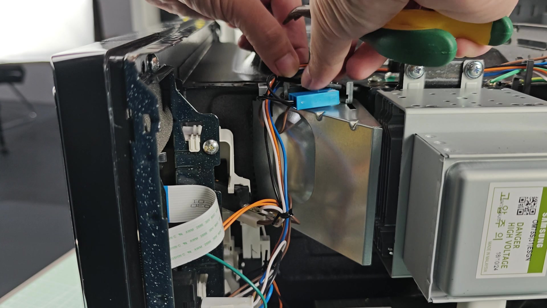

When I saw the question about replacing interior lights on Samsung microwaves I figured I'd bring it up since people comes across it so often. The work involved is less than the panel or magnetron job I see on here.

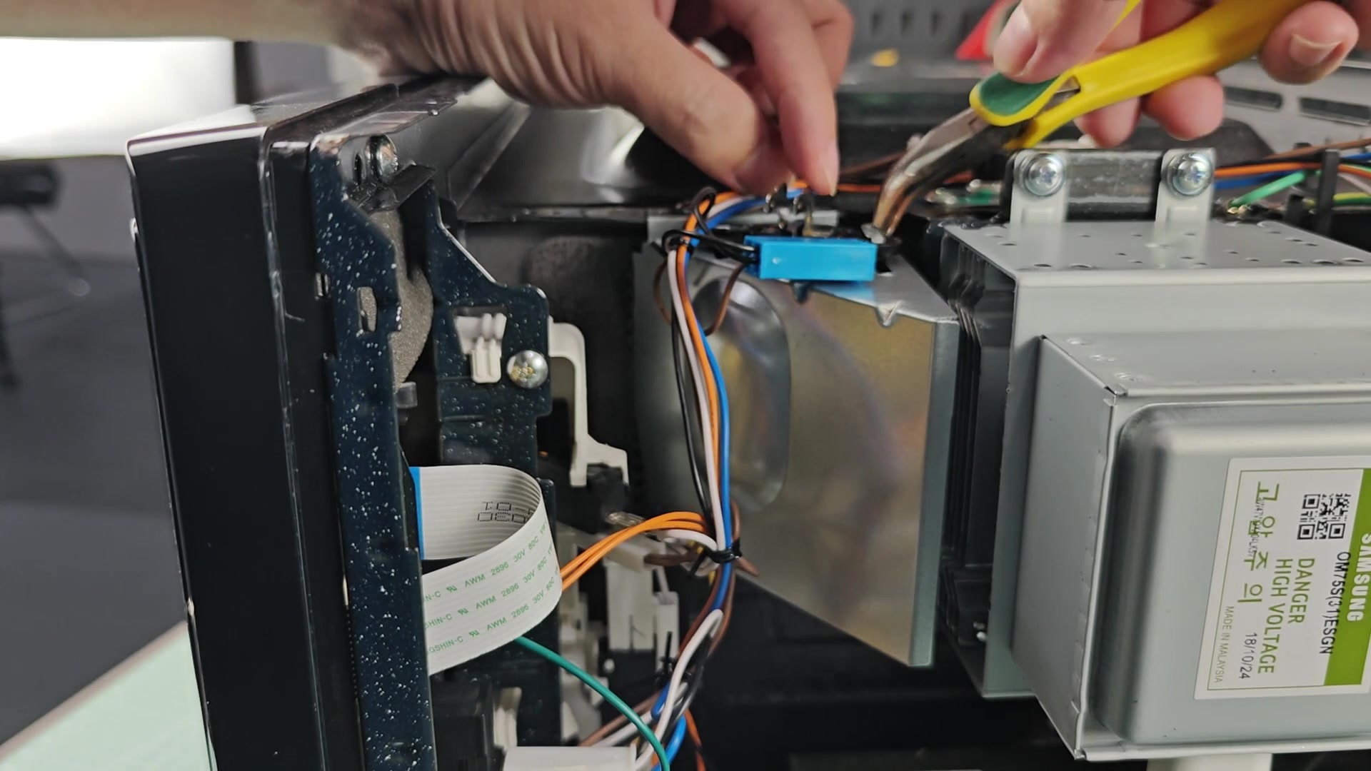

Basically it involves removing the microwave’s power plug (those caps can bite!) removing the outer cover of the microwave and removing the wiring from the light bulb. Then simply replace the bulb with a new one of the same specifications and reattach all the wires and the outer cover.
Only question I have about the lighting on these Samsung microwaves is if the specification for the light bulbs are consistent across most of the models. From what I understand the OTR models use 30W or 40W bulb as they also heat the cooktop while countertop units use 20-25W bulbs. Correct me if I’m wrong though. Does anyone encounter difficulty with removing the outer cover of the units? I know some have hidden screw under the vent grille. Anyone who’s had a chance to inspect one recently? Does the socket ever develop issues with these units or is it always the bulb that die?
those caps can bite is putting it mildly. A buddy of mine got knocked on his ass discharging one with a screwdriver, didn’t even cross his mind to wait.
Bulb spec definitely vary. OTR units are either 30W or 40W, since they heat the cooktop. Countertop models are 20-25W. The spec is on the unit behind the door, next to the model number.
wait does the bulb actually need to match wattage exactly or can I just use a lower wattage bulb?
You can go with lower wattage bulbs no problem. Higher wattage bulbs lead to overheating of the housing where the bulb live. Most LED bulb do not handle the microwave environment very well. I’d recommend using an incandescent bulb for the microwave.
cover being a pain is an understatement on the OTR models. Mine had two screws on the back of the microwave, two hidden under the vent grille and then another one behind the filter where I nearly missed it for 20 minutes! Countertop models are easier to remove the outer cover though; 3 Phillips head screw on the back of the unit.
